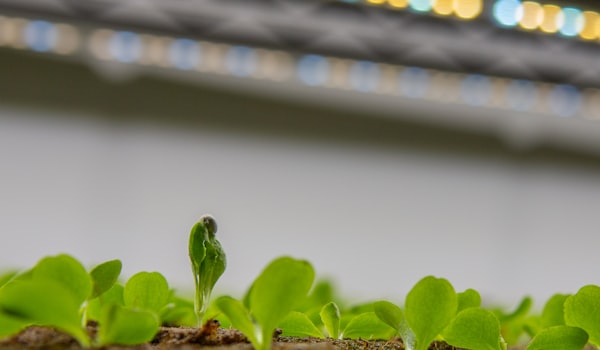

Once the seeds germinate and raise their little heads out of the dirt, you can turn off the blanket and turn on the fluorescent light (the lights will now provide the heat). Use a timer and set the light to stay on about 18 hours a day. The lights should hang just two or three inches above the seedlings, and be raised little by little as they grow. It’s important to keep those lights hovering just above the plants. If hung too high, the plants will grow tall, spindly, and weak as they strain to seek out the light. A short, stocky plant is a healthy plant.

Misanthrope layed out a solid blueprint for northern seed starting, and I’d like to build on that with a few modern twists and observations from my own experience in zone 4b (last frost around June 5). The traditional fluorescent shop lights are still great, but full-spectrum LED grow lights have come down in price dramatically over the past few years. They draw half the power, produce significantly less heat (meaning you can keep them closer without cooking the seedlings), and the better ones have a Kelvin rating in the 5000-6500K range that mimics daylight. If you’re building a plant stand, swapping to LED strips designed for horticulture (or even just daylight LED tubes) will save on electricity and reduce the need for heating blankets in warmer rooms. That said, the heating blanket tip is golden for peppers and eggplants — soil temperature makes a huge difference in germination speed.
