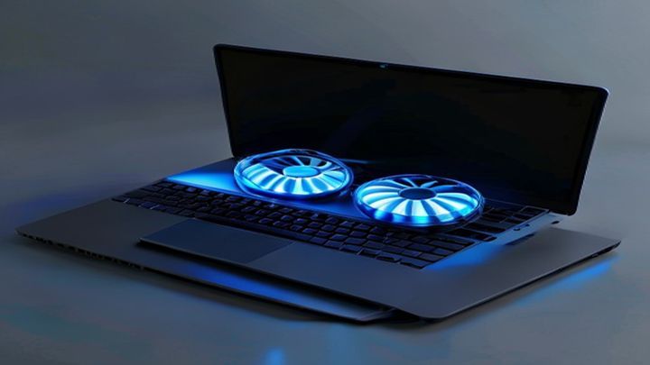

A few weeks ago I finally got my hands on a laptop cooling pad. I have a Dell XPS 17-inch and it was constantly overheating, hitting 105-110°F under load. I found a cooling pad with great reviews for about $23. After using it, my temps dropped to 96-98°F even after 20 minutes of use. It’s not a miracle but it definitely delays the heat buildup. The cooler covers most of the laptop, especially near the RAM, but barely reaches the built-in fans. Still, worth the investment. I also tested battery life: with USB power and laptop unplugged for an hour, I didn’t notice significant battery drain, maybe 10-15% depending on fan speed. Overall, it’s a solid budget solution. What cooling methods have you tried? Any success stories or lessons learned?
RECONSTRUCTED ART
[[Mock-Up Representation: A large laptop cooling pad with two 120mm fans and blue LED lights, sitting under a Dell XPS laptop]]
Topic Summary: $23 cooling pad dropped Dell XPS 17 temps from 105-110°F to 96-98°F under load, minimal battery drain (10-15%/hour). Worth the investment.
