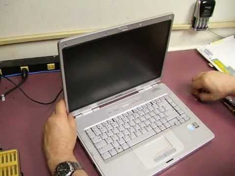

I’ve replaced dozens of laptop screens over the years, including on Presarios. My honest take: unless you have a specific attachment to that model, it’s not worth the hassle. Replacement screens for the Presario 2100 typically run $30–60 on eBay if you look for ‘Compaq Presario 2100 LCD’ or search for the part number (usually on a label on the back of the screen). But don’t expect other brand 15-inch screens to work — the connectors and inverter boards vary wildly.
If you want to keep it as a desktop, just plug in an external monitor. That’s free. The laptop will still work fine.
For repair, check the YouTube tutorials. Search ‘Compaq Presario 2100 screen replacement’ — there are a few detailed guides. Also, consider posting on forums like Badcaps.net; those guys know vintage screen mods.
Personally, I’d salvage the hard drive and RAM, and buy a used ThinkPad from 2015 for ~$100. But if you’re doing it for the love of retro tech, go ahead and swap the screen. Just be careful with the bezel clips — they get brittle with age.
I’ve been through this exact dilemma with a few Compaq Presario units, including a 1600 and a 2100. The YouTube video on replacing the LCD on a Compaq C581WM is a good starting point—the process is nearly identical for the 2100. The main difference is the bezel design; the 2100 has more clips that love to snap when you pry them. If you go the repair route, I’d recommend watching that video a couple of times before touching the bezel.
The Wikipedia article on the Compaq Presario 1200 gives some useful context—that generation of Compaq laptops used a mix of standard LVDS panels, but each model had its own firmware quirks. The 2100 is essentially a later iteration of that same chassis design, so you’re unlikely to get a drop-in replacement from a Dell or HP. Stick with a screen labeled specifically for the Presario 2100 or one that shares the exact same Compaq part number. I’ve had success finding those on AliExpress for around $35–45, but be patient with shipping times.
The Mermaid diagram in the discussion lays out the cost/portability decision cleanly. I’d tweak the $50 threshold slightly: if you can find a screen for under $40 and you already have the tools, the repair is worth it for the experience alone. But if you’re looking for a daily driver, RetroFixer’s advice to grab a used ThinkPad is solid. The 2100’s CPU and RAM limits are going to frustrate you even with a good screen—those early Pentium 4-M chips run hot and slow by modern standards.
One thing nobody mentioned: the inverter board on the 2100 is prone to failing even if the screen isn’t cracked. So if you replace the LCD and still get no backlight, that’s the next suspect. Test the existing screen with an external monitor first to confirm the GPU is fine before investing any money.
If you decide to keep it as a desktop, an external monitor is perfectly fine—I ran a Presario 2500 that way for two years. But that defeats the portability of a vintage machine, and part of the charm is having a fully functional retro laptop. For me, the satisfaction of bringing a 20-year-old machine back to life outweighs the marginal cost. Just know what you’re getting into: brittle plastics, tiny screws, and a lot of patience required.
