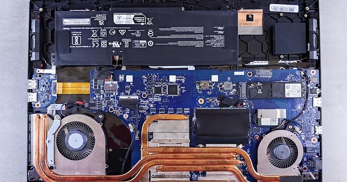

That said, I ran a Compaq Presario back in the day—those things had awful thermal design. A cooling pad is just a band-aid. If your laptop is old and hot, consider replacing the thermal paste and cleaning the heatsink fins. That alone dropped my old ThinkPad by 20°C.
As for CFM: bigger fans (120mm) generally move more air at lower noise, but the key is static pressure for pushing through tight vents. For a laptop cooler, you want fans with high static pressure, not just high CFM. Noctua’s industrial fans are overkill, but something like Arctic F12 PWM work great for a DIY build.

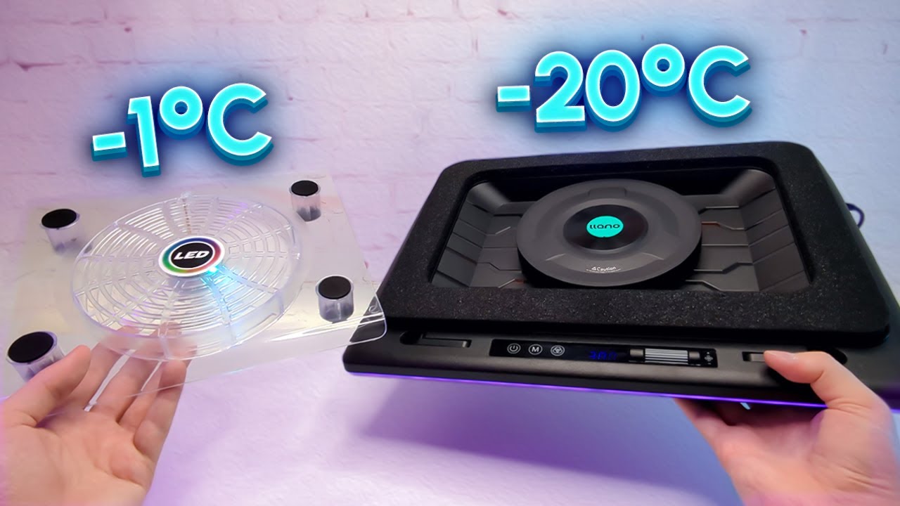

I recently watched that YouTube video “Is It Worth Buying A Laptop Cooling Pad?” which essentially tested a dozen pads across different laptops and workloads. The takeaway was that cooling pads only help when the laptop’s own fan already has headroom—they can’t overcome a choked heatsink or crusty thermal paste. The biggest temp drops came from pads with large, high-static-pressure fans (like 140mm) and proper foam seals around the intake vents. The USB power limitation was brutal: most pads using dual 60mm fans at 5V moved maybe 30 CFM combined, while a single 120mm fan at 12V can push 70+ CFM. The video also highlighted that the angle of the laptop matters—tilt improves natural convection even without fans.
