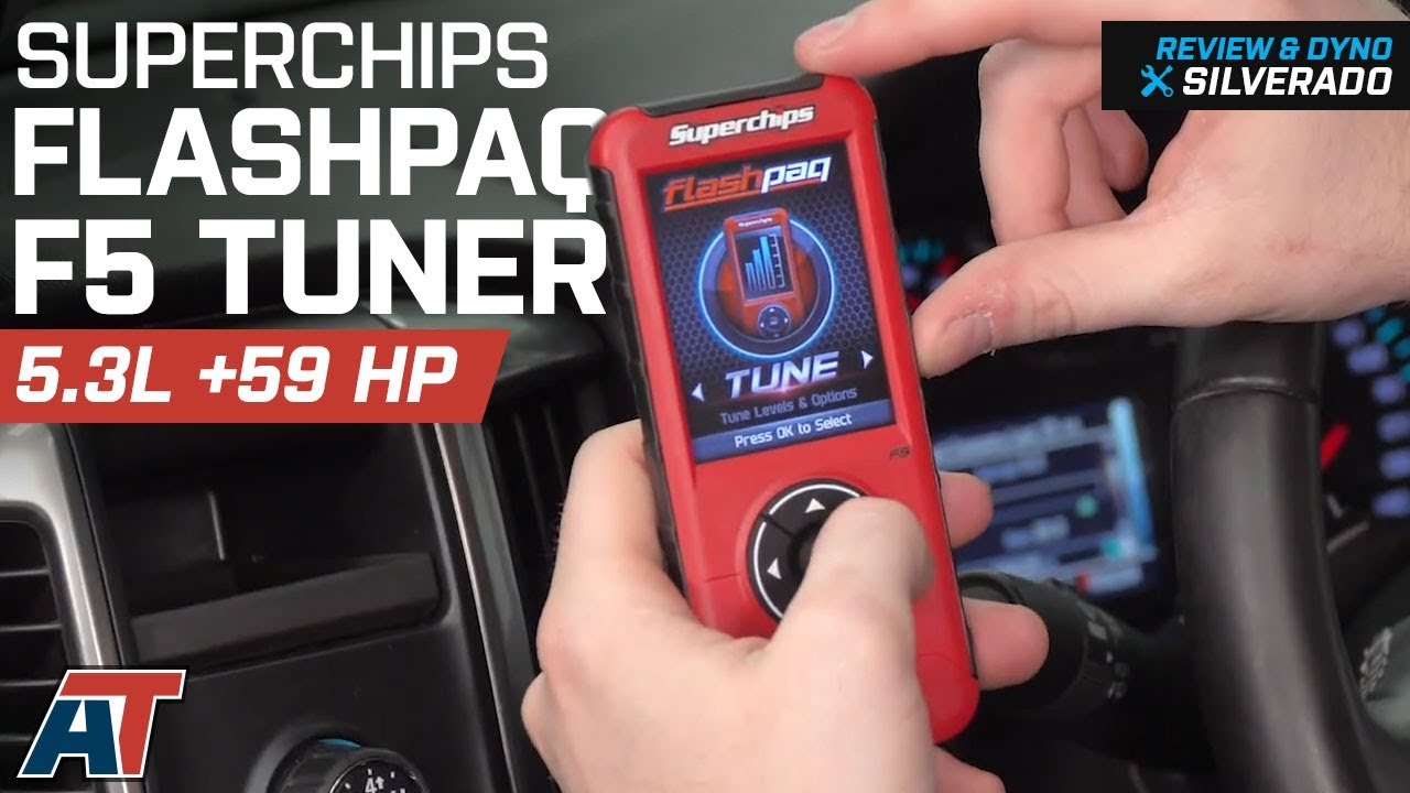

No, no, and no. Sorry, but those bolt-on parts won’t give you the gains you’re hoping for. Exhaust and intake might add 10-15 hp combined, but for towing, you need torque, which comes from proper tuning. Skip the ‘chip’—modern trucks use ECU tuning via a handheld tuner like SCT or DiabloSport. Also, consider a transmission cooler and upgraded brakes. Don’t waste money on a K&N; a dry-flow drop-in filter is better for towing. Read up on forums like Diesel Place or F150online.
I’ve been down this road with my F-150. David789 is spot on about tuning being the key. I went with a custom tune from a local shop using HP Tuners, and the difference in towing performance was night and day—especially the transmission shift points. One thing I’d add: don’t overlook the importance of a good trailer brake controller. The integrated ones are nice, but aftermarket units like the Prodigy P3 give you more control. For those considering exhaust, a cat-back with a moderate tone is fine, but avoid straight pipes—drone on long trips will drive you nuts. What’s your truck’s engine and year? That can really narrow down the best tuning options.
