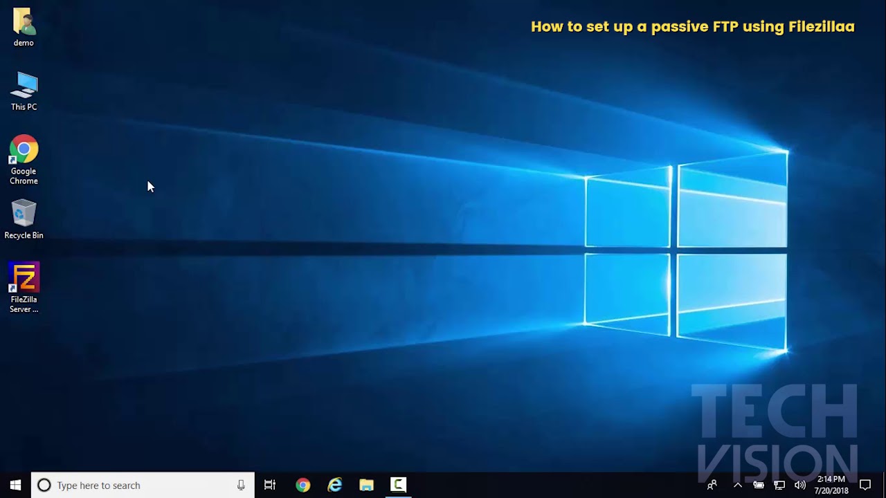

  1. Configure FileZilla’s Passive Mode
    • Go to Edit > Settings > Connection > FTP
    • Under “Passive mode”, select “Failover” or “Use the server’s external IP address”
    • If your Xisto account is behind a firewall, you might need to enter the external IP manually (check in cPanel > FTP accounts)
