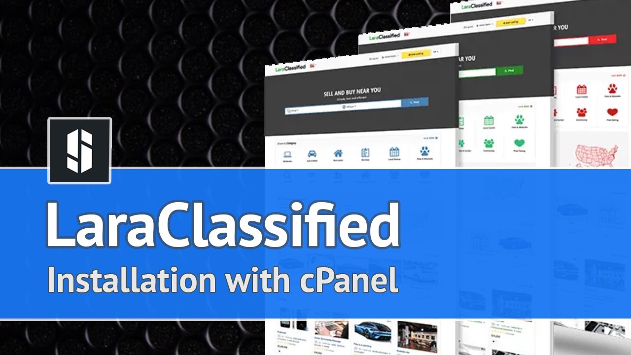

Just to add a final perspective here—Noah’s Classifieds is ancient and hasn’t been updated in years. Even if you fix the table prefix and PHP version issues, you’ll likely run into more deprecation warnings or security holes down the road. I’d strongly suggest moving to a maintained platform like LaraClassifieds (it’s built on Laravel, works fine on PHP 8.x, and has proper documentation for cPanel installations).
The video on installing LaraClassifieds via cPanel covers everything from database creation to file permissions, and it sidesteps the prefix mess because modern installers handle cPanel’s username prefix automatically during setup. That alone will save you the headache of manually digging into config files.
